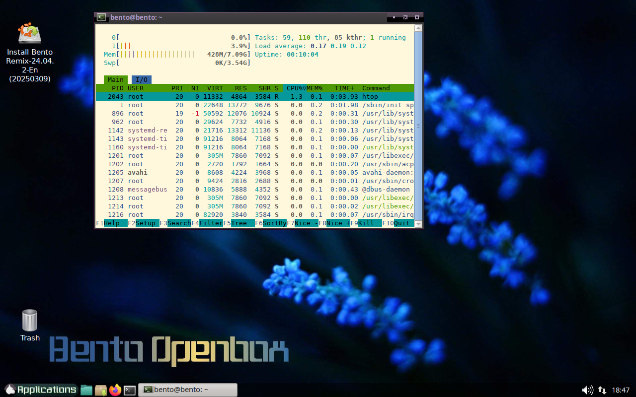

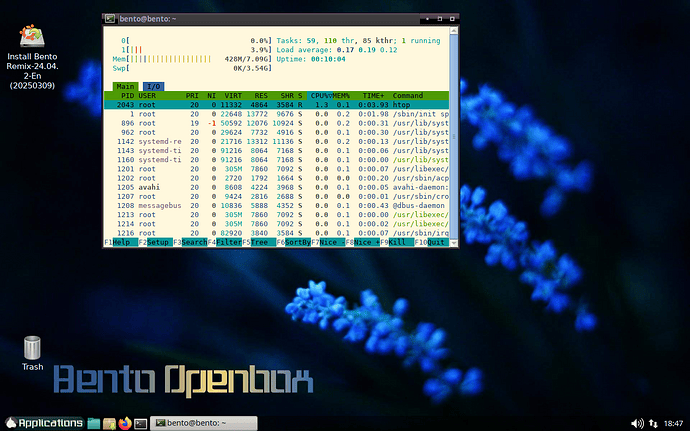

The last versions of Bento Openbox Remix come with the mozilla ppa, fit for Firefox and for Thunderbird.
(Thus snap isn’t installed). It is presented at and available from https://linuxvillage.org/en
I just started it in Virtualbox and launched the htop processes manager. (My own install having several heavy programs would not be the right example to show).
PS : it has been out since 2012, though there was not yet a full English + a full French version available until recently.
