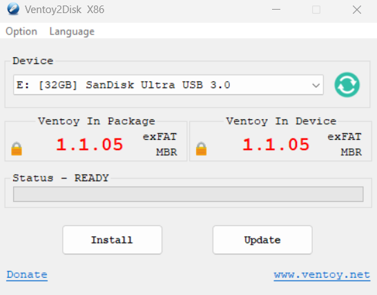

Totally agree on balenaEtcher being cross-platform and that’s a major advantage when working with volunteers on macOS or Linux. I do often still use Rufus for quick tasks on Windows (especially when building ISOs with persistence), but it’s definitely not cross-platform friendly.
Ventoy, though, is the game changer. I use it daily and I’ve built a multiboot key with dozens of distros and repair tools (Rescuezilla, GParted, Boot-Repair, etc.), and I just drop updated ISOs onto it as needed. No formatting, no hassle. Combine that with a script for silent updates and it’s a dream.
