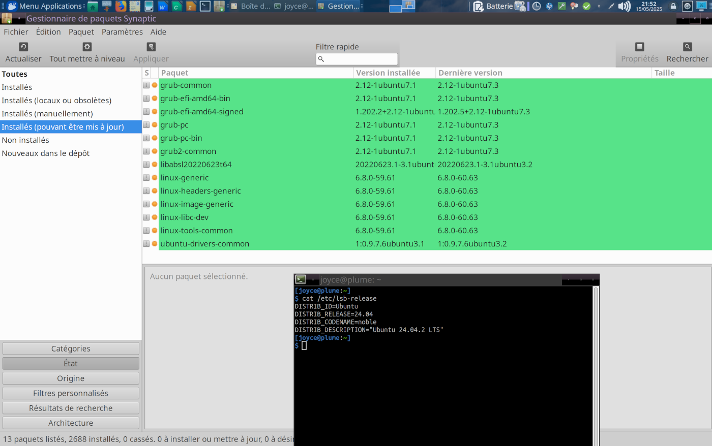

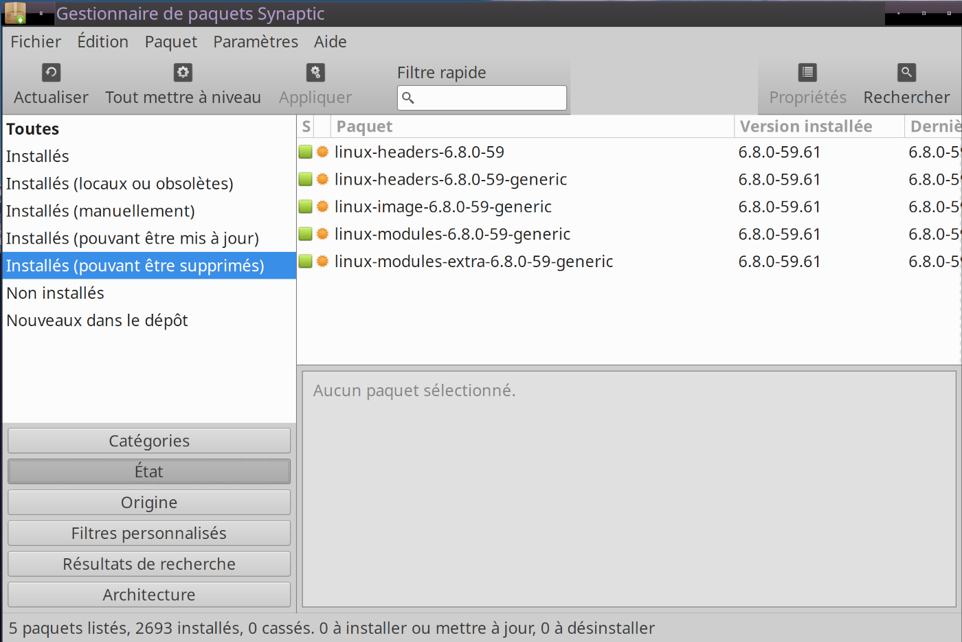

But in Ubuntu, in Debian, and in all clean derivatives you get to have a proper Synaptic working the way the Debian community created it!!! (And when it was out, were they proud, with good reason!)
Not that impaired ghostic version that Linux Mint has made of it.
Have a look at the Synaptic package manager in Linux Mint, compare with the one in Debian or Ubuntu, check the menus, especially ones in the Setup menu, and on the left sidebar down “State” under “Categories” regularly, and with Debian and Ubuntu you will realise you don’t need command lines. The cleaning which can be done is available there.
And what about the equivalent of sudo apt dist-upgrade. In Synaptic you can select one way or the other. (In the menu “Setup > Preferences > General” there are several choices, “dist-upgrade” graphical equivalent in Ubuntu is “Smart update”, which can also be debatable, on the principal, but right technically for desktop use).
Sorry about the screenshots in French. I have found myself unable to configure LC_ALL or LANG=C the right way, in order to start some applications in English. (I haven’t tried very hard either… )

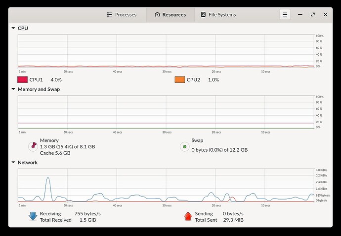

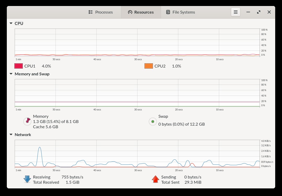

Yesterday I had a chance to have a quick look at Endless OS. There’s a 4 GB ‘basic’ ISO as well as the super big one. Install was very simple. Installed on an old Core 2 Duo (non UEFI), as well as an old HP Pavilion. The installer wanted the whole disk - couldn’t see any option for dual booting.
Apparently the tip is NOT to set any user password. It seems doing that activates a root password - which you don’t know - and that can cause problems down the road.
Seemed slow at first - but it could have been just settling in. Being an immutable the first thing I tried was to mess with it:
“su root” - wouldn’t let me
“sudo apt install [blah]” - wouldn’t let me
tried to edit a config in /etc/ - again - wouldn’t let me
Installed in 13.1 GB. Here’s a screenshot on Core 2 Duo, once it settled down:
Frustrating thing for me - couldn’t find any way to search for software in the Package Manager. Default browser is Chromium
It uses Ext4 (not Btrfs like some) and keeps the immutable side under control with OSTree. The
“OSTree model is like git in that it checksums individual files and has a content-addressed-object store. It’s unlike git in that it “checks out” the files via hardlinks, and they thus need to be immutable to prevent corruption.”
With any regular update of packages - a new immutable OS image is made by including the new updates. The old OS image is retained as a rollback. Just reboot to switch to the new one. There’s a terminal command to rollback - and, it seems, you can also choose which one in Grub.
Everything else is slapped on top of the immutable as flatpacks. More secure than regular Linux - and WAY more secure than Windows.
Main thing here is that it’s much more foolproof than regular Liinux - perfect for people transitioning from Windows who may be scared because of what they’ve heard about Linux.
Remember - any windows user who has an Android device is already using Linux - or at least a bunch of stuff wrapped around a Linux kernel. Android works in a similar way - similar foolproof concept.
BTW - the Endless ISO doesn’t like playing with Ventoy. Not trying to have a dig at Ventoy - just that some ISOs don’t like that environment. It’s as if they’re saying “where am I”. So I burnt it to a DVD - only to rediscover something I’d forgotten - that the optical drives on old hardware rarely work properly - at least not without a gentle wipe over of the lens with isopropyl alcohol. So - a spare USB stick later …

Looked at a news site about some flooding that’s happening close by me - that maxed out both CPUs - though it still didn’t appear to really slow it down. I’ll try it again when I’m in on Monday - but with uBlock this time - see if that makes much of a difference.
