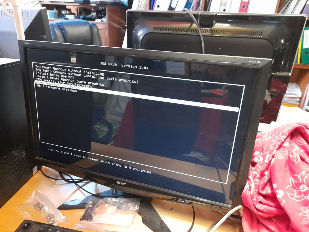

Booting
Looks like there’s just something about the old Dell it doesn’t like (Opitplex 960 + Core 2 Duo E8400). And - my bad - it isn’t the installer as the Grub menu. On the HP Pavilion both Ubiquity and Calamares quickly boot to a bare bones Grub menu - and then proceed without problem. On the old Dell it first boots to what must apparently be a highly customised Grub? It then appears to hang - unresponsive - for about 5 to 6 minutes before proceeding to desktop.
I don’t understand what you said related to Grub and to install, in it isn’t the installer as the Grub menu ?
GRUB meaning GRand Unified Bootloader, it is not concerned by the installer, so, what were you trying to say?
You tested on two different machines. Your feedback would help better with specific details for each. It might take more of your time to do that, of course.

Just in case you’re not aware of this. Happens with the ISO on Ventoy (Boot in normal mode). Boots to a plain Grub.
Happens on the HP Pavilion (p6-2414a with AMD A6-5400K dual-core APU) - both with Secure Boot on (& Legacy disabled) - or Secure Boot off (& Legacy Support either on - or off).
Some other odd behaviour - when the Bento ISOs are burnt directly to a USB stick - the HP’s not seeing them for Boot Menu unless Secure Boot is off and Legacy enabled (but does see them in the BIOS menu under Device Configuration). It sees other ISOs to boot from just fine (Debian 12 & AnduinOS). I’ll double check with all three of the Bento ISOs tomorrow. Using Balena.
It’s a very reflective screen. Had to take the “screenshot” from this angle to avoid bright reflections.
I cleared the HP’s NVRAM earlier today because it was clogged up with so many previous installs.
BTW - having just used Krita to resize this image - it’s not that bad.
This is the expected behavior when using Ventoy, as Ventoy is compatible with both UEFI and legacy BIOS boot.
