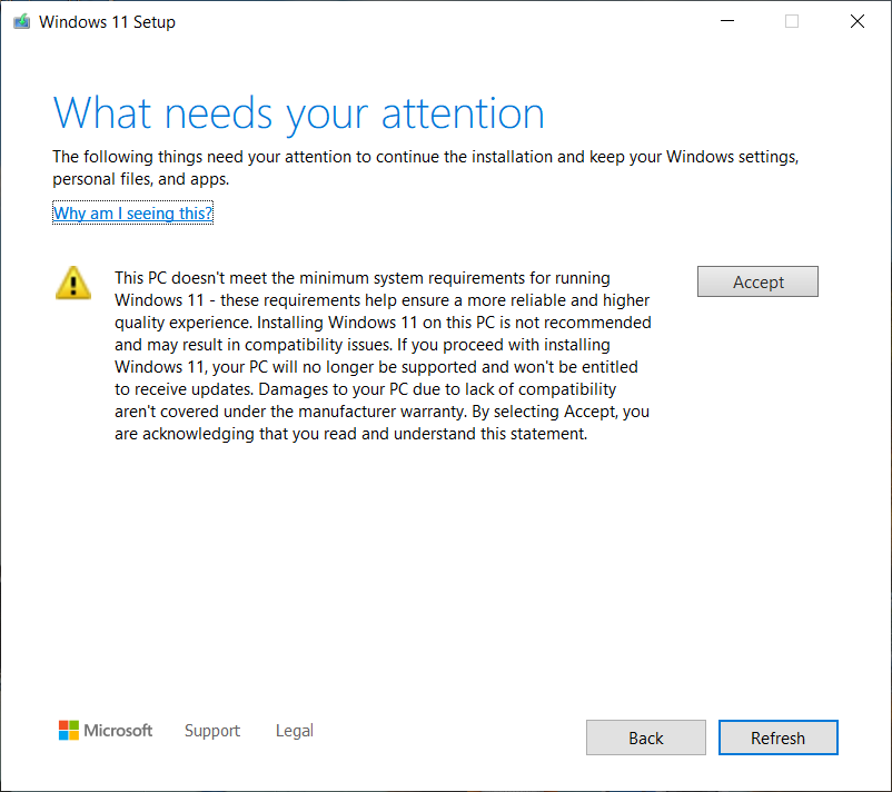

I’m currently running two unsupported machines - on one of them, I get this pop-up :point_down:
So Microsoft have a marker that the rules are being negated - I wonder how (or if) they’ll leverage that.
That’s interesting, I’ve not seen that before. (but then I haven’t booted my Win 11 in a while :wink: ) … Yes, they do reserve the right to break things in the future.
Apologies - I didn’t make it clear that the message popped up during install.
However, now I think about it, I didn’t use Rufus, but some registry hacks (as it was an existing W10 installation). I wonder if that is the reason.
Using Rufus makes a difference, Rufus applies these “bypasses”:
Selected Windows User Experience options:
• Bypass SB/TPM/RAM
• Bypass online account requirement
• Disable data collection
• Use ‘X’ for local account name
• Use the same regional options as this user’s
• Disable bitlocker
So the setup willl not warn you if your computer doesn’t support the right TPM version, for example.
Another benefit: no need to create an online account !
