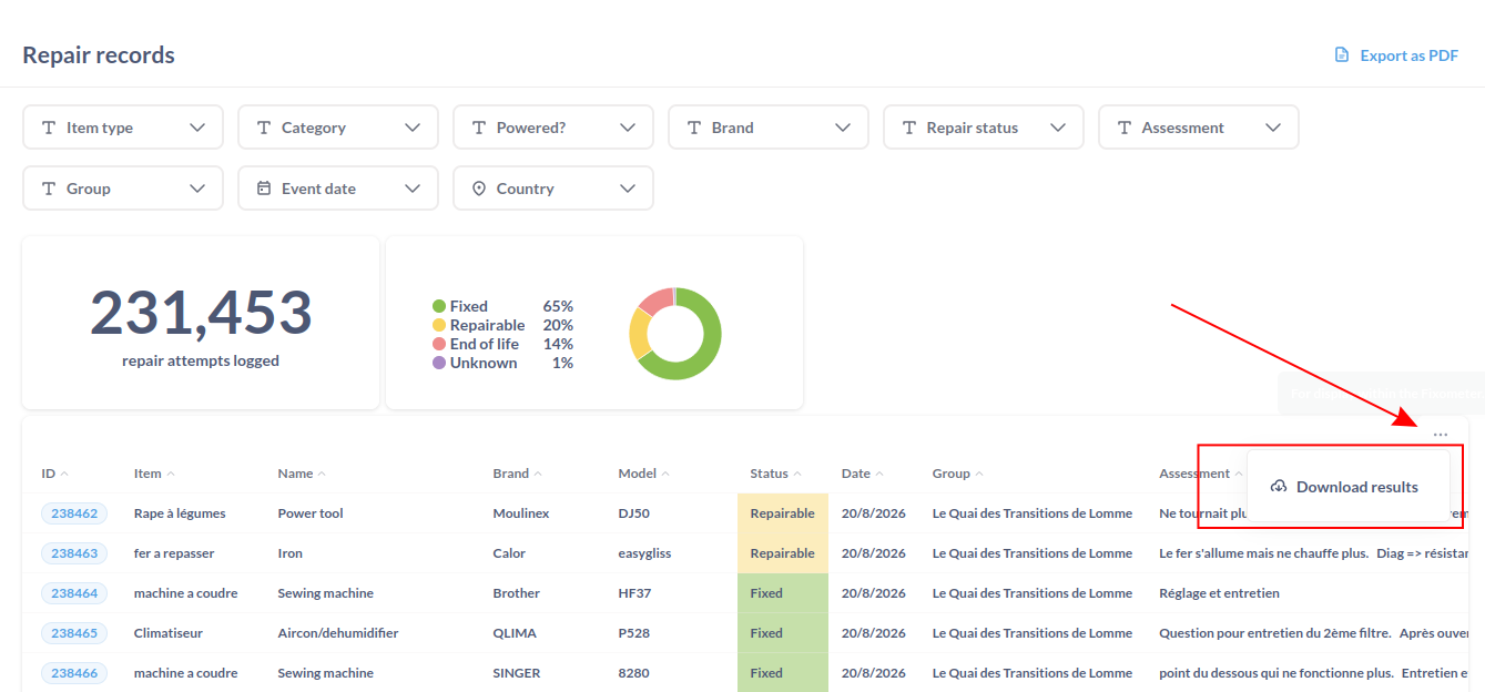

I am a tech volunteer for Repair Café Montreal and would like to do some root cause data analysis on the Fix-O-Meter data. Ideally that would be a CSV download just like the Repair monitor data. Unfortunately I haven’t find that possibility. Is this thing possible and if so, where can I download a full or partial dataset ?
Thanks in advance.
David P.
Hi @David_POELLHUBER ,
Welcome!
You can download the repair records from the Fixometer here.
That said, I think you may have already found and accessed the Open Repair Alliance data. That contains more records, across more datasets pooled together, so may be the best place to start for your analysis.
Best wishes
Neil
Thanks a lot Neil for showing me that option. I noticed that unlike the Repair Monitor, a single assessment field concatenates the problem and sometimes the fix. I’ll see what AI can do to sort this out.
