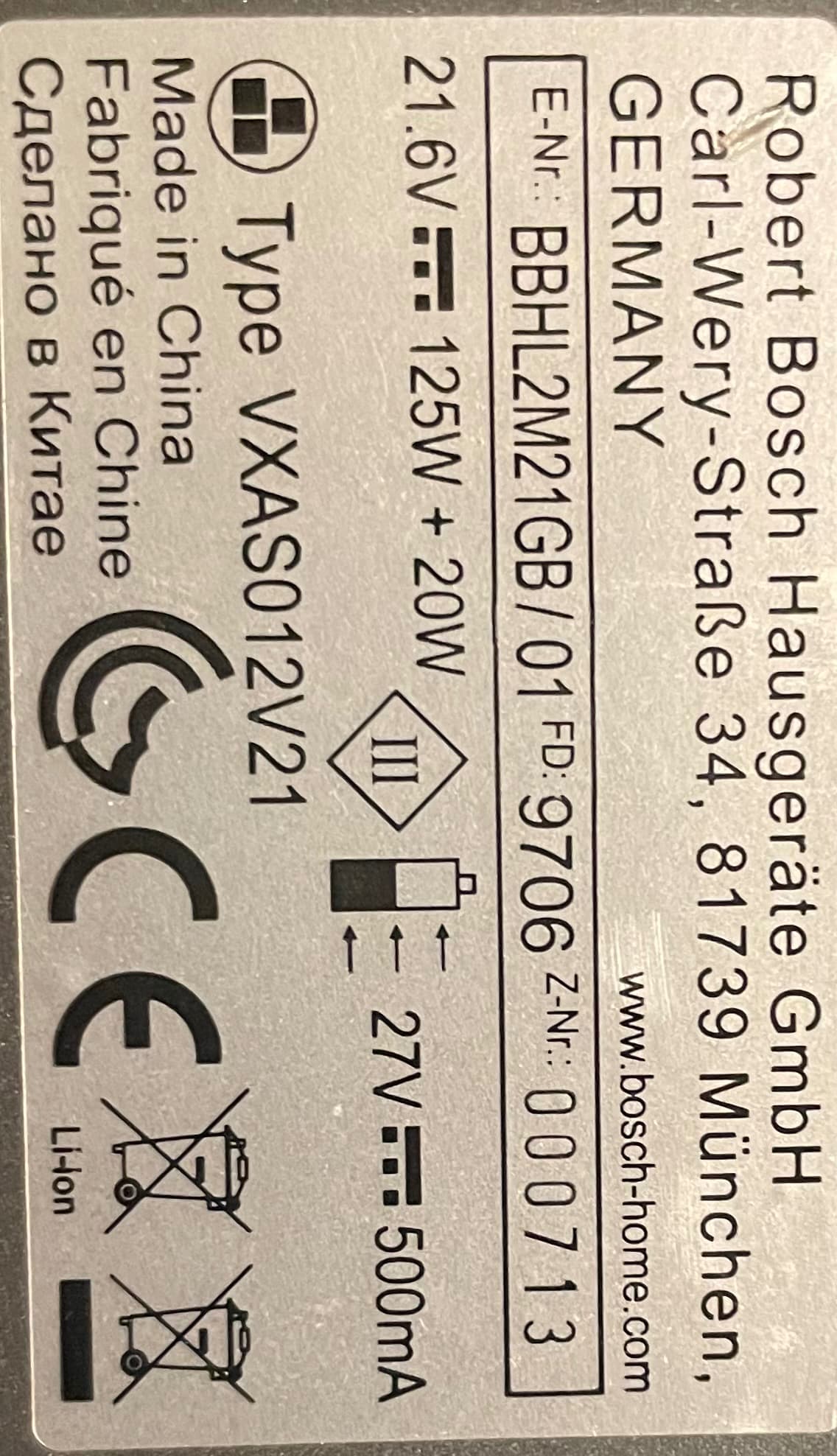

I am wanting to replace a battery inside a Bosch Readyy’y Vacuum cleaner. Bosch will not supply. new battery only a new chassis (motor and battery unit), sold for the price of a new vacuum cleaner. Anyone able to give me some guidance about what battery to get / what tools I might need or if someone can help me do it?
What’s the exact model number?
Thanks for responding Ian,
I believe it’s a Bosch Readyy’y series1 although not written anywhere on the cleaner
On some items, once the battery get below a certain voltage, the circuit does not have the power to power the BMS. On other systems the BMS locks the battery out.
If yours is the first type, slowly charge via constant current by 0.1A (0.1C) from 0v to about 3.3-ish V. From this point onward the charger should be able to take over.
From 3V to 4.1v charge at 1C, so I usually choose 1A. You could user a 4V psu with 47ohm in series to limit current too
