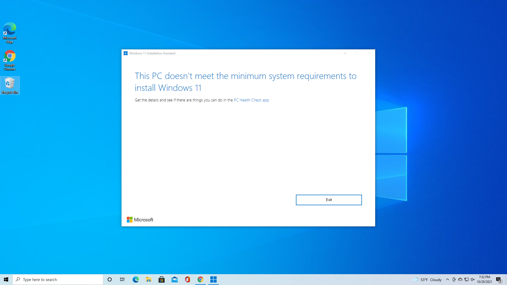

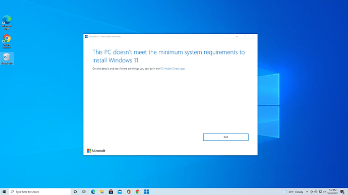

I think your Windows 11 CPU support is incorrect.
According to Microsoft you need an 8th gen or newer intel CPU to natively run windows 11. These came out in 2017 so the desktop/ laptop would need to be from 2018 to run Windows 11.
I refurbish old laptops for donation and will be moving to Linuxmint (Cinnamon) with some instruction for the users on what the differences are. I hope this will be OK as i do not see any other option as 90% of the laptops I get will not run windows 11.
This is exactly what I was pointing out regarding the narrow-mindedness around the end of Windows 10. Again, I’m not here to reignite a debate about Linux Mint or other distributions. In fact, I’m the first to promote Linux and I’m even :heart::heart::heart: pro-Linux at heart :heart::heart::heart:. But what bothers me here is this greenwashing trend: pushing Linux as the “only solution,” under the pretense that Microsoft has “abandoned” support for older processor generations. In reality, it’s not that black and white.
The list of processors published by Microsoft is complete, but it misses a crucial detail: the latest version of Windows 11 (23H2 and 24H2 ES - Extended Support), with Microsoft’s official unlock, supports a much broader range of 64-bit processors, even those that Microsoft supposedly removed for OEMs. Yes, Microsoft decided to drop support for 8th, 9th, and 10th-generation Intel CPUs for OEMs, but consumers are not affected. It’s a strategy of planned obsolescence, nothing more. In fact, the installation of an unmodified Windows 11 version from Microsoft’s MSDN goes perfectly fine on these machines, even the so-called “incompatible” ones.
Even better, I managed to install Windows 11 on i3-2xxx series processors, provided you start with an initial installation of 23H2. Once that step is completed, the update to 24H2 ES proceeds smoothly. And where it gets even more interesting is that on most branded laptops and PCs, you just need to activate the advanced options in the BIOS (often hidden by default), and you get access to Secure Boot. Once enabled, Windows 11 installs without a hitch.
For example, I even managed to install it on an old PackardBell with an AMD N1600. Let’s be honest, it’s a bit slow for Windows 11 (very very very veyr very very very very slowly even with 16GB of DDR3 and a good SSD), but the installation went through because Secure Boot and TPM (even 1.x and in rare case 2.x) were active. And it doesn’t stop there: I also installed four Dell Inspiron 17R SE today, all equipped with Ivy Bridge i5-3210M at 2.5GHz. Sure, PC Health Check complains a bit, but the installation goes smoothly. I just added a bit of RAM, and the generic NVIDIA drivers work perfectly for the GT 650M.
What needs to be understood is that a PC capable of supporting an SSD, a bit of extra RAM, and that isn’t crippled by ridiculous BIOS limitations, can perfectly run Windows 11, even if it’s a bit old. Now, are the ISOs we use in the company modified? Honestly, I have no idea, but I found the same versions with the same checksum online, and the link pointed directly to Microsoft’s servers.
I also recommend the tool Builder from rg-adguard.net. It’s really impressive, sometimes a bit slow to generate the ISOs, but of impeccable quality, and they are indeed official Microsoft versions. You even get the Insider options, so there’s nothing suspicious there.
In summary, this pseudo-obsolescence is just an illusion: with a bit of configuration, old PCs run perfectly well on Windows 11.

Ah, the “Microsoft Official Unlock” I referred to is simply a small trick: it’s just a text file you add to your ISO or USB key to bypass the Windows 11 hardware checks (TPM, Secure Boot, RAM, etc.).
It’s not a hack and it’s based on Microsoft’s own official method for deployments.
Here’s what you do:
  1. Create a text file named:
    ei.cfg
    (no .txt at the end!)
  2. Place it inside the sources/ folder of the ISO or USB.
  3. Inside the file, paste the following content:
[Channel]
_Default
[VL]
0
That’s it! When you boot from the USB, the Windows 11 installer will skip the hardware checks (TPM 2.0, RAM, etc.).
Let me know if you want a version that also skips the account creation/online requirement that’s possible too.

Yes, it’s the same principle as using Rufus to create a bootable USB and remove the hardware requirements (TPM, Secure Boot, RAM, etc.). If the upgrade tool says your 7th gen CPU is not compatible, that’s due to Microsoft’s strict requirements, but it can still work perfectly fine in practice.
To perform an in-place upgrade without losing your files or programs:
  1. Download the official Windows 11 ISO: https://www.microsoft.com/en-us/software-download/windows11
  2. Use Rufus to create a bootable USB stick: https://www.rufus.ie
  3. When using Rufus, select the options to remove TPM, Secure Boot, and RAM checks. You can also create it manually with the ei.cfg file. Same result with or without Rufus.
  4. Then run setup.exe from the USB directly inside your existing Windows 10 system, or reboot and boot on the USB to start the live installer.
    • This will launch the upgrade process and, in most cases, preserve all your files and applications. If you reboot and use the USB installer, make sure to choose “Update (Upgrade)” and not “Advanced” when prompted during setup.
Let me know if you want the exact step-by-step instructions for the ISO and Rufus tool.
