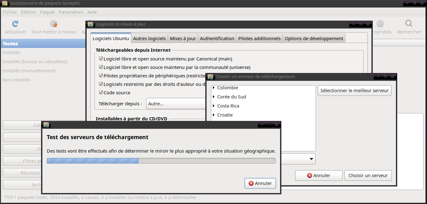

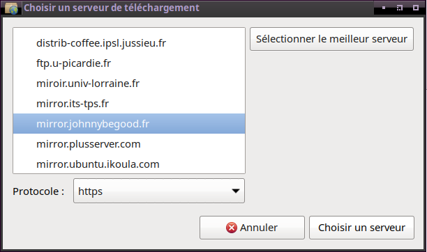

I don’t know if you are missing something, but Linux Mint might be. Their Synaptic is not the original one, as I have explained in other posts.
In Debian, Ubuntu, antiX Linux, MX Linux and any Debian and Ubuntu other derivatives, you will go to the menu Setup > Repositories > Click on the Download From drop down menu, then choose Other… and once there, you can click on the button at the right : “Select the best server”.
This will take a few seconds or minutes, and it will pick one for you based on the time a ping sent to all servers will need to reply. Once you get the result, you can click on the button “Choose a server”.
When a new server is chosen, don’t forget to reload the information for the sources (it would be the same as getting a new catalog of the packages available in that repository).
I am not sure Linux Mint provides these kind of options. Does it? I just remember I would not recognize the Synaptic I have always known, last time I had a Linux Mint in front of me.
