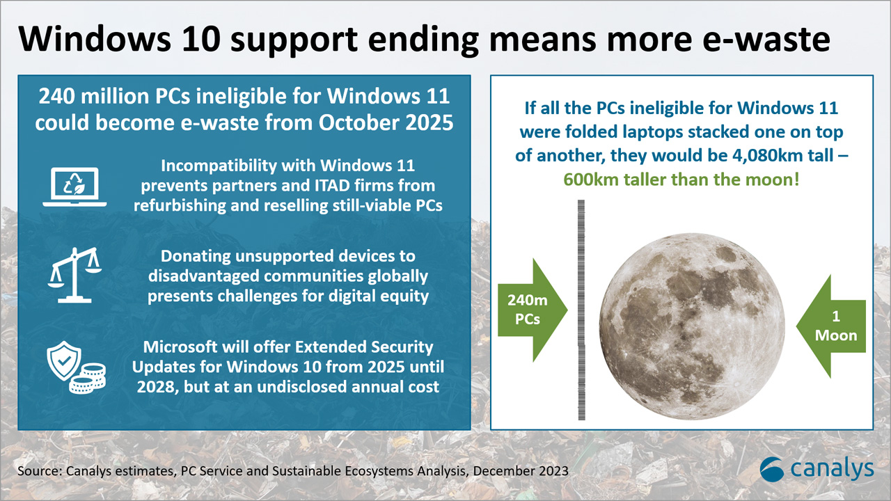

“The end of Windows 10 support could turn 240 million computers into e-waste.”
Well, yes and no. Only a small fraction of those devices will actually be affected. This is one of the common misconceptions surrounding the Windows 10 EOL, a bit like the Y2K panic. It’s become the dominant narrative, but in reality, the situation is far more nuanced.
In truth, only a few, like tens of millions (which is still a lot) will be truly impacted. Because in most cases, if a machine can run Windows 10, it can run Windows 11 and without needing to tweak or “unlock” anything.

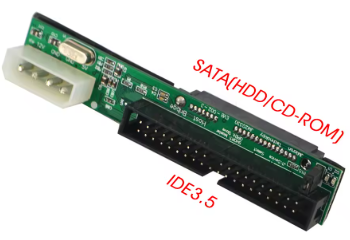

Hi, just to go off-topic. Unsure if you know, you can put a SSD drive into an IDE pc with a convertor, like this below from Ali. It is usually small enough to still fit into most drive slots. They are about £4 from Ali, just make sure that it has IDE pins on one side to fit the cable socket, and a socket on the SATA side to fit the PCB if the IDE.
The bad side is that not all BIOSes may be able to access a 120gb drive, you still will be transferring data at the lower EIDE speed too.
This number which has been repeated throught the web, comes from Canalys Insights.
I has also been reported by the GreenIT.fr non for profit association : https://www.greenit.fr/2024/01/16/fin-de-windows-10-37-276-687-millions-de-tonnes-eq-co2-evitables/
Emphasize on the word could which is of course a possible scheme (yet to happen).
(BTW who is this Canalys company? https://www.canalys.com/about/our-story)

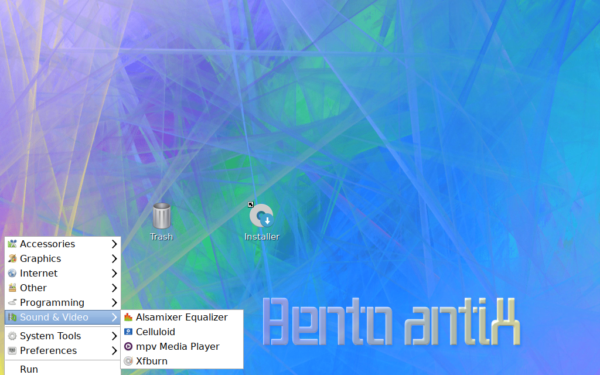

Bento Openbox makes use of some of the components which form the LXDE Desktop Environment, though not all.
Bento Openbox Remix is an Ubuntu lighter than Lubuntu, not supported by Canonical. The recipe started in 2009 for a very old laptop of mine. It was first build with PCLinuxOS https://pclosmag.com/html/Issues/201109/page01.html
In 2012 it has been ported to Ubuntu. A few years later, a test with antiX was done, the descriptions are linked in this page:
antiX didn’t play well with attempts to upgrade last year, so it is on stand-by for now. The full recipe will soon be on Github for all to create their own spinoffs using it. (Main goal : the lightness of the Openbox advanced window manager - https://openbox.org - with the same comfort as a full fledged Desktop Environment).
The Ubuntu version works very nicely, but it can’t be provided for 32bits computers or low ram computers.
Typically when a machine does not take more than 2GB RAM, 32bits versions are preferred. Then for
these machines, for now I suggest MX-Linux, or eventually antiX Linux (either or of their versions) as they also both rely on the Debian sources for their large choice of applications/packages.
About Openbox : it is desktop agnostic, so you can install a full desktop on top of it later, if you’d like to. I have installed xfce4 desktop on top of it in one of my computers, and chose the session using the options at the login screen.
While I’m at it, feedback and feature requests are welcome (not sure all requests can be adressed, but they are still welcome).
