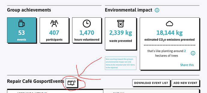

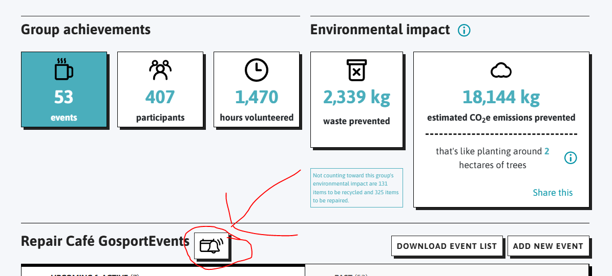

One of the really cool features of Fixometer is the ability to subscribe to all group events in your personal calendar feed. Which you access from a button on the group page:
That provides a link, for example: https://restarters.net/calendar/group/410 for Repair Cafe Gosport. Put that into your preferred online calendar, then the magic happens.

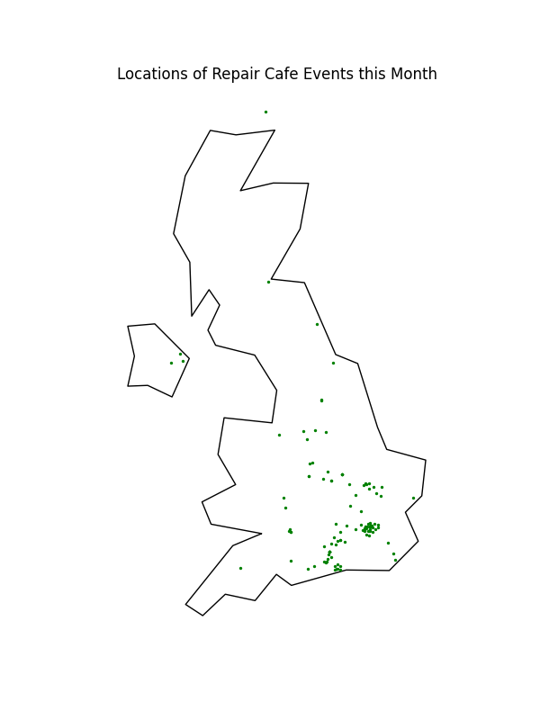

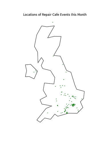

I have made a Python wrapper for the API. I looked at using an automated generator from the open-api definitions, but that was not making full use of the Python features, so I ended up hand-coding it in the end.
It can be downloaded from pypi: pyRestarters
All the code is in GitHub: https://github.com/krcb197/pyRestarters
One of the examples is making a map of all the UK repair cafe events this month:
